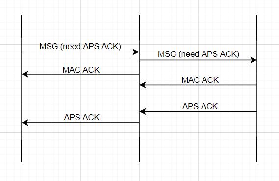

The above figure shows the handshake process of normal communication.
MAC ACK is a point-to-point response, while APS ACK is a message response that can be relayed.
For sleep ZED devices that require frequent message reception, it is recommended that the polling rate not be less than 6 seconds.
Because the time for the parent node to cache messages for SED is 7.68 seconds, the messages will be discarded after timeout.
