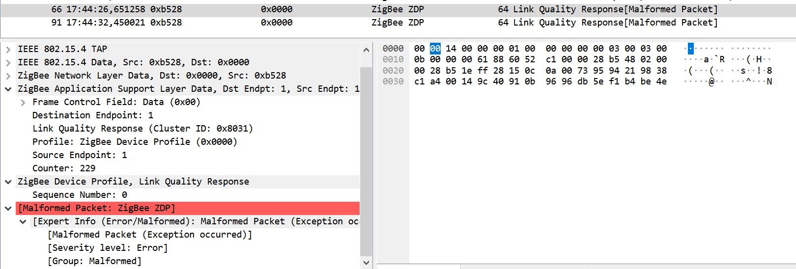

Hi.
I want to get the signal level of my device (LQI).
  1.     int8_t rssi = ZB_RADIO_RSSI_GET();
  2.     ZB_RADIO_RSSI_TO_LQI(0, rssi, lqi);
复制代码
ZB_RADIO_RSSI_GET always returns a value around -100.
I would like to request LQI from the coordinator.
