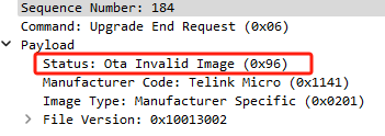

ota 到最后结束时,设备提示 ota invalid image. 什么意思? 怎么处理?

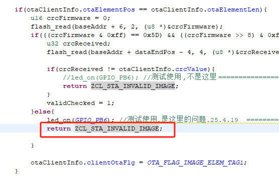

 楼主| 发表于 2025-4-19 10:02:11 | 显示全部楼层 来自 广东深圳
是这里CRC异常,怎么解决?

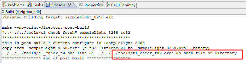

fff 发表于 2025-4-21 08:38
谢谢,没有理解你怎么解决的。怎么操作的。
The problem I had was that the file tl_check_fw2.exe in tools directory was missing - it was deleted by antivirus. The CRC is added to the end of the firmware file. This files generates CRC after compilation.
At the end of compilation I had the following message:
    "../../../tools/tl_check_fw.sh" ht7017 tc32
    this is post build!! current configure is :ht7017
    copy from `ht7017.elf' [elf32-littletc32] to `ht7017.bin' [binary]
    ../../../tools/tl_check_fw.sh: line 6: ../../../tools/tl_check_fw2.exe: No such file or directory
    **************** end of post build ******************
If you have the same message (after you clean the project and recompile it) check the tools directory if you have file tl_check_fw2.exe.

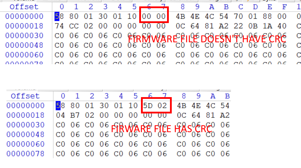

You can also open your firmware file with any hex editor and have a look at offset 6-7. You should have 5D 00 if there is CRC in the firmware file
That's what is checked in this function first - it is reading flash_read(baseAddr + 6, 2, (u8 *)&crcFirmware);
flash_read(baseAddr + 6, 2, (u8 *)&crcFirmware);    if(((crcFirmware & 0xff) == 0x5D) && ((crcFirmware >> 8) & 0xff) == 0x02){
You may have a different reason. That was my problem.

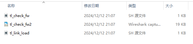

 楼主| 发表于 2025-4-21 15:38:42 | 显示全部楼层 来自 广东深圳
我参考了文件夹,没有这个tl_check_fw2.exe 文件
