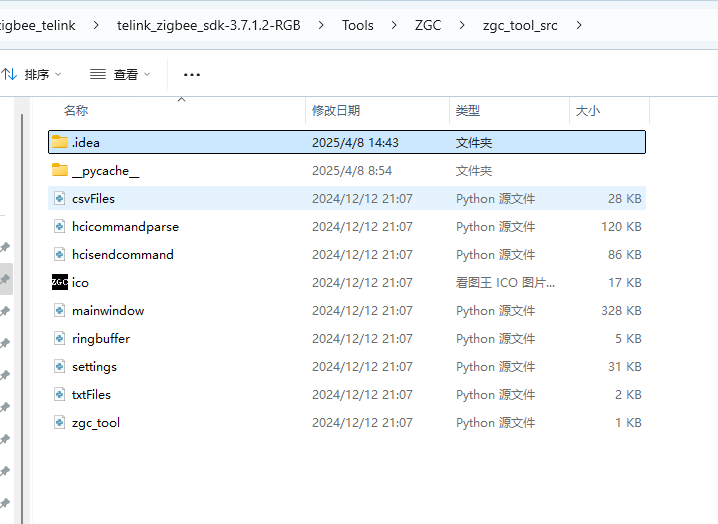

You have to have Python installed on your computer and then run zgc_tool.py.
When you run it you will get some errors and you will see some missing python libraries/packages.
You will have to install them as well.
Telink should have done it better and provide all necessary libraries
It is interesting that in the Zigbee SDK Developer Manual they say:
4) Auxiliary control software on PC (ZGC)
• Zigbee_gateway_controller.exe
But this doesn't exist.

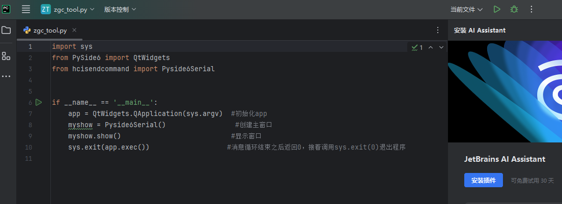

 楼主| 发表于 2025-4-8 11:37:18 | 显示全部楼层 来自 广东深圳
我安装了这个,打开了zgc_tool.py,没有效果。

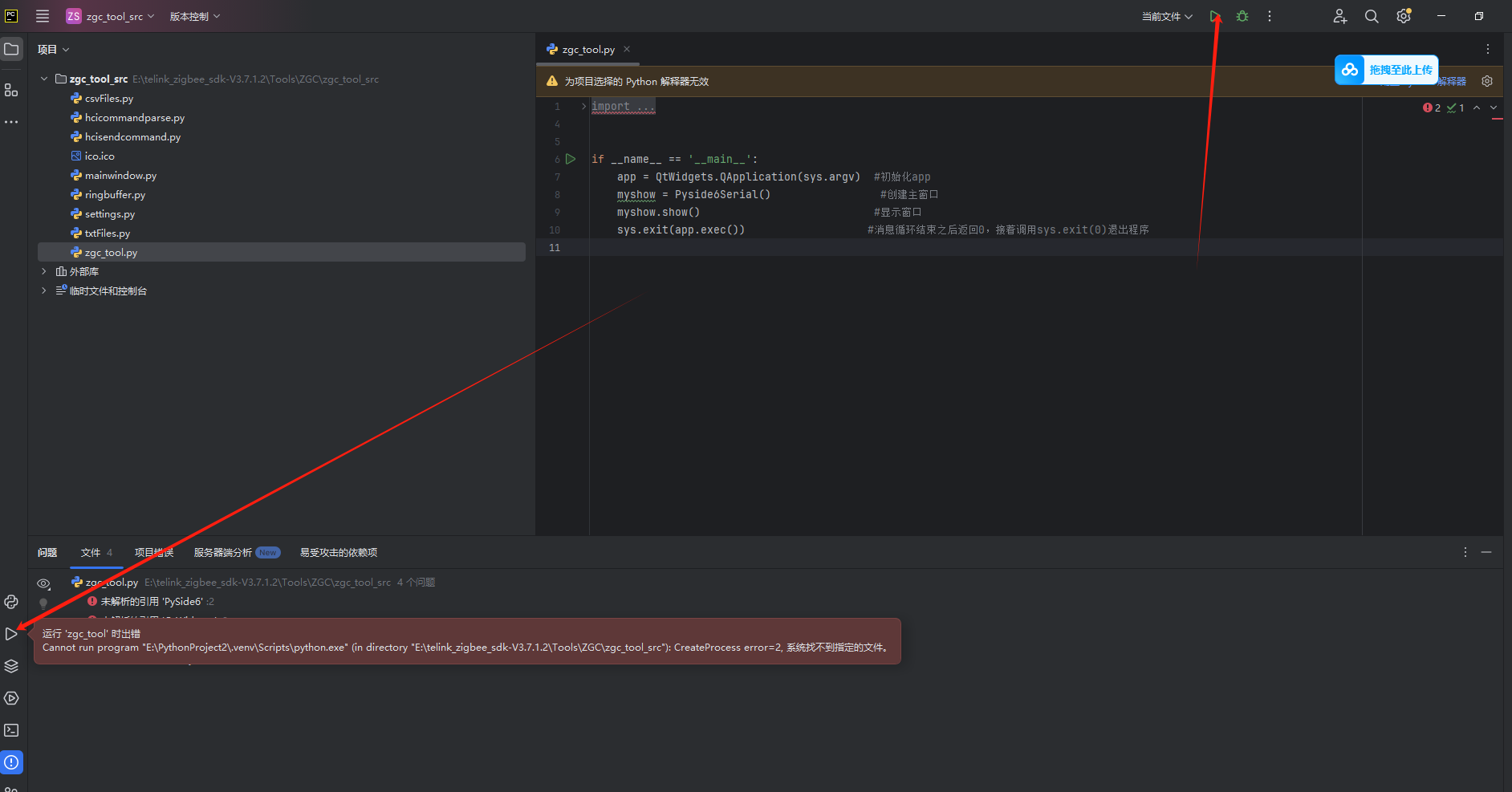

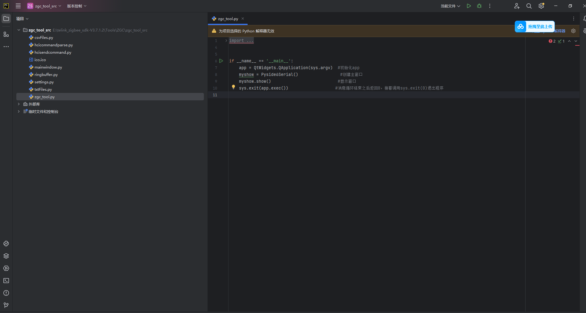

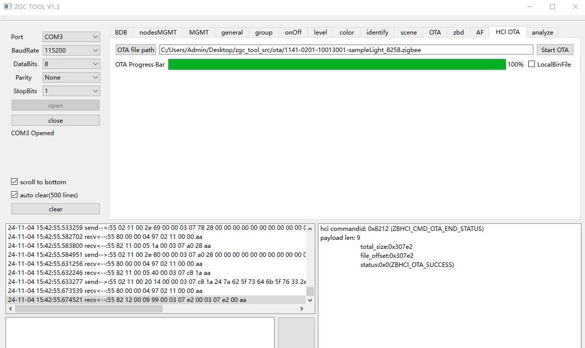

发表于 2025-4-8 14:12:26 | 显示全部楼层 来自 广东珠海
image.png 你需要把zgc_tool_src这个文件夹的内容导进去, image.png 我这里就是因为没有配置好环境,报错,我另外的电脑配置好了之后,点击运行,那个上位机就出来了

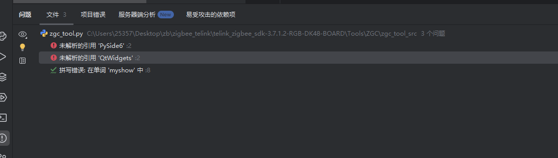

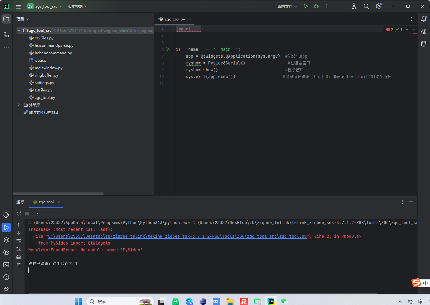

 楼主| 发表于 2025-4-8 15:03:29 | 显示全部楼层 来自 广东深圳
出现这样的错误

发表于 2025-4-9 05:05:51 | 显示全部楼层 来自 澳大利亚
fff 发表于 2025-4-8 14:50
我按照你方法尝试了,没有看到上位机。 是否可以直接发出你的上位机我
So it tells you that you have to install module PySide6.
To install it you have to do:
pip install PySide6
Then you will get another module missing and you would have to install them.
On other pictures you have it written in Chinese which I can't understand.
