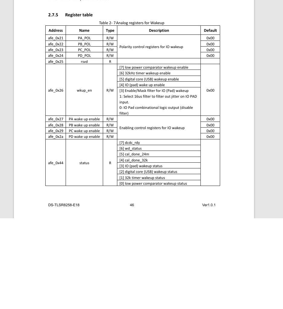

how to make Wakeup source - USB ?
how to make wakeup via gpio via analog register
_attribute_ram_code_sec_noinline_ void analog_write(unsigned char addr, unsigned char v)
or via
#define reg_gpio_irq_wakeup_en(i) REG_ADDR8(0x587+((i>>8)<<3)) // reg_irq_mask: FLD_IRQ_GPIO_EN

The 8258 does not have a USB wake-up mode.
