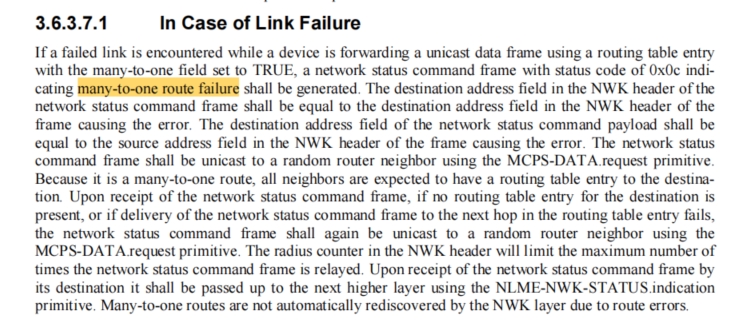

Hi, In many-to-one Zigbee, In which case the router will send the MTO route error?

发表于 2025-4-3 17:13:26 | 显示全部楼层 来自 上海
