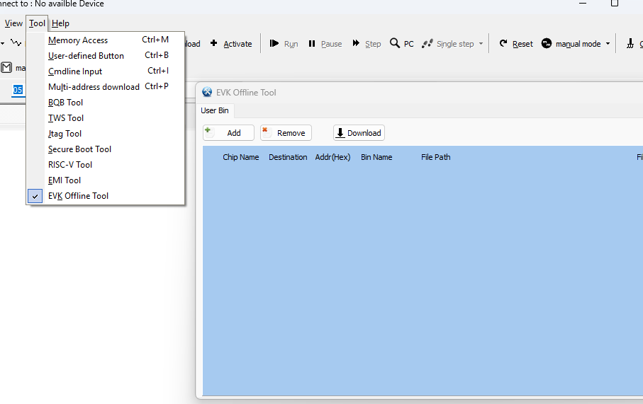

        •         Firmware loads correctly into the EVK under the “EVK Offline Tool → User Bin” (selected as B80).

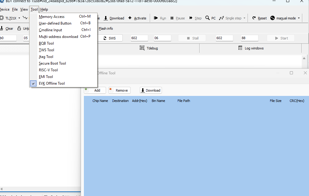

Thank you for the response!

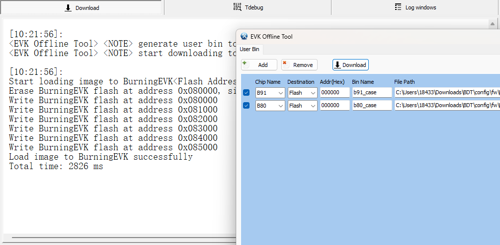

For me the offline button does not show up in the web interface. However, I did manage to use the EVK Offline Tool in the windows BDT.
The problem is that the programmer does not actually program my devices. So after I have loaded the binary onto the programmer, I connect the programmer to my device (with blue LED on) and press SW1, but nothing happens.

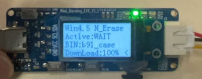

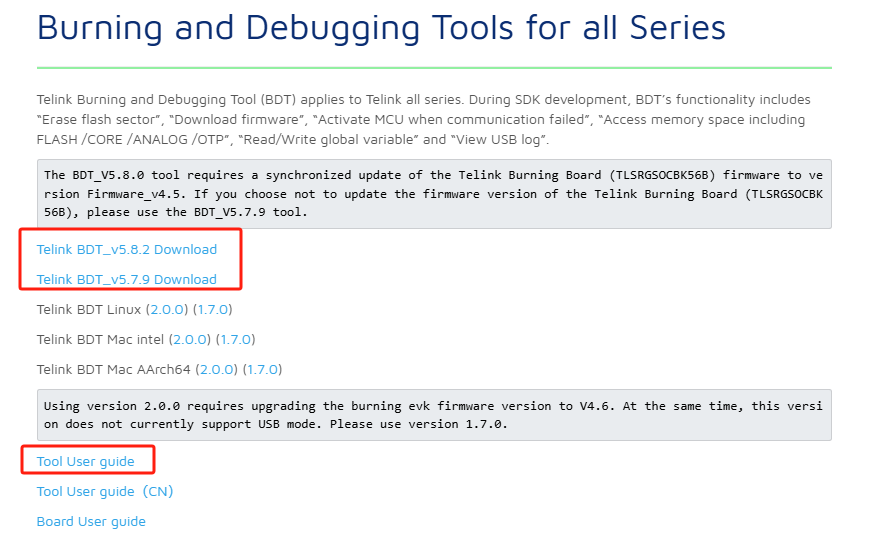

If you want to use the offline download function, you need use the Mini_Burning_EVK,The firmware version can only be 4.0 to 4.5.
It should be noted that when using the latest bdt tool to download firmware to the chip, there is a possibility that the flash may become locked. In such cases, attempting to download firmware using an offline programmer may fail, as offline programmers do not unlock the flash.
The instructions for using the Mini_Burning_EVK: https://doc.telink-semi.cn/doc/en/openplatform/Mini_Burning_EVK/
This Mini_Burning_EVK can be used in conjunction with BDT or WEB BDT.

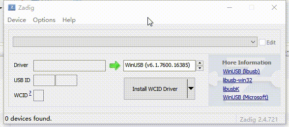

Steps for using WEB BDT:

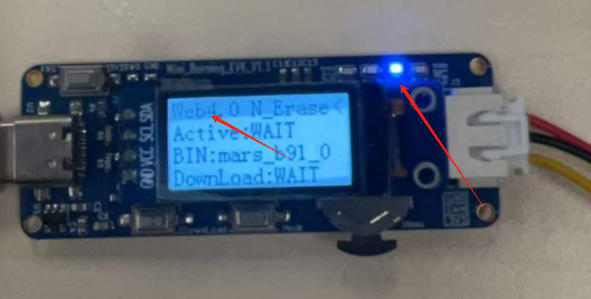

1、click the mode button to switch to web bdt mode. at this time, the downloader will only have a blue light on. after plugging in the USB and powering on the downloader again, you will see web4.x string displayed on the screen.

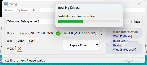

2、download Zadig:https://zadig.akeo.ie/,select the Telink Web Debugger v4.x and click the replace driver.after successful prompt, unplug and plug in the USB to power on the downloader again

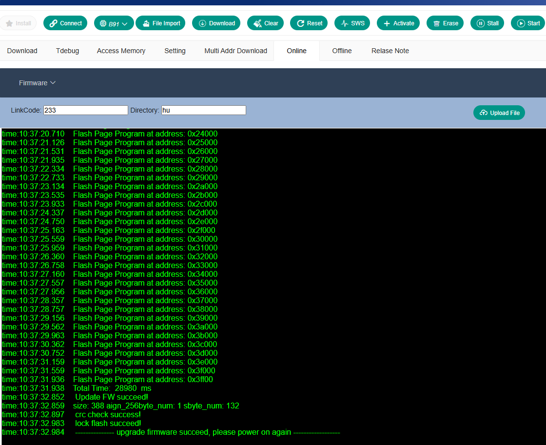

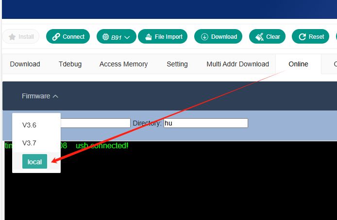

3、open the web bdt:https://doc.telink-semi.cn/webtool/web_bdt the web bdt document:https://doc.telink-semi.cn/doc/en/openplatform/web_bdt/

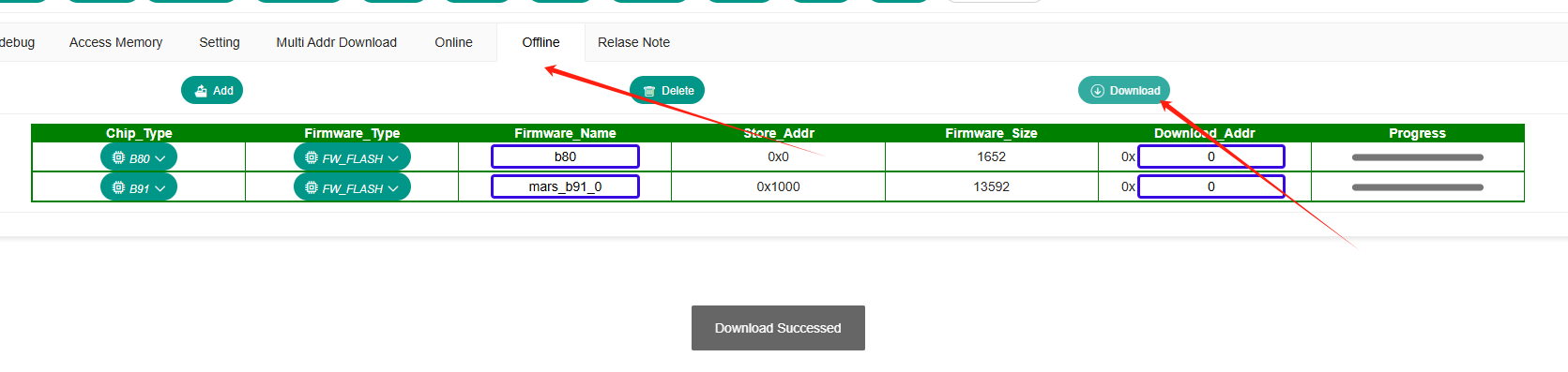

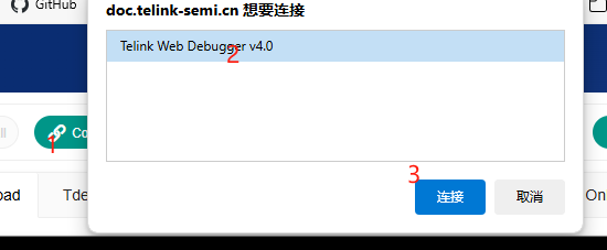

4、download offline firmwares according to the following screenshots
e3ee21e0c5364ff0c85caac49718cdd.png 4ebc8afce8b06330d13c3f2e53b75ce.png 3ced05acbb20fabd6600cb801070111.png

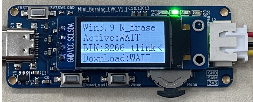

2、click the mode button to switch to win bdt mode. at this time, the downloader will only have a green light on. after plugging in the USB and powering on the downloader again, you will see win4.x string displayed on the screen.
3、open windows bdt and download offline firmwares according to the following screenshots

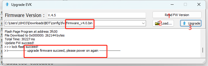

You can according to the following screenshots to update the firmware of the Mini_Burning_EVK.
