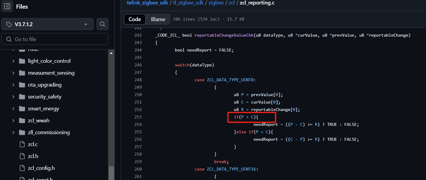

AFter changing from SDK ver 3.6.8.1 to 3.7.1.2 I have noticed that I had an issue with reporting. The reports were working fine for many years but now the reports are sent continuoulsy even though the value didn't change, and I can't access the chip.
I have the reports configured (as in all your sample projects)
/* Set default reporting configuration */
    u8 reportableChange = 0x00;
    bdb_defaultReportingCfg(SAMPLE_LIGHT_ENDPOINT, HA_PROFILE_ID, ZCL_CLUSTER_GEN_ON_OFF, ZCL_ATTRID_ONOFF,
                            0x0000, 0x003c, (u8 *)&reportableChange);
After checking the code in old and new SDK I found the following in the zcl_reporting.c
SDK ver 3.6.8.1
_CODE_ZCL_ bool reportableChangeValueChk(u8 dataType, u8 *curValue, u8 *prevValue, u8 *reportableChange)
    bool needReport = FALSE;
    switch(dataType)
        case ZCL_DATA_TYPE_UINT8:
                u8 P = prevValue[0];
                u8 C = curValue[0];
                u8 R = reportableChange[0];
                if(P >= C){
                    needReport = ((P - C) > R) ? TRUE : FALSE;
                }else{
                    needReport = ((C - P) > R) ? TRUE : FALSE;
            break;
And in SDK ver 3.7.1.2
    switch(dataType)
                u8 C = curValue[0];
                if(P >= C){
                    needReport = ((P - C) >= R) ? TRUE : FALSE;
                }else{
                    needReport = ((C - P) >= R) ? TRUE : FALSE;
            break;
        case ZCL_DATA_TYPE_UINT16:
So now, when reportableChange = 0, and no change in previous and current values of data, the reports are sent continuously. Before it had to be greater than reportableChange for the report to be sent.

发表于 2025-3-7 13:46:14 | 显示全部楼层 来自 上海
Hi,
This issue is fix in v3.7.1.2.
(https://github.com/telink-semi/t ... zcl/zcl_reporting.c)

 楼主| 发表于 2025-3-8 06:20:24 | 显示全部楼层 来自 澳大利亚
TL_YB 发表于 2025-3-7 13:46
Hi,
Thank you.
You should say it was fixed in "V3.7.1.2_Patch_0001"
I had V3.7.1.2 downloaded in December last year with this issue!
