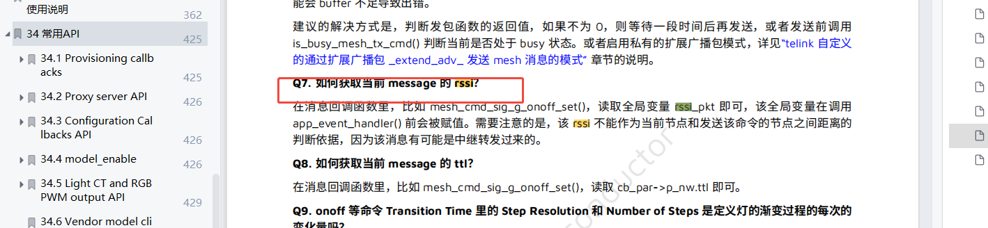

发表于 2025-2-12 15:24:17 | 显示全部楼层 来自 广东深圳
如果这条消息不会被转发(也就是发送端的ttl设置为0),是可以用说的方法进行距离估测的。

thank you for reply.
I have already checked the documentation and understand what "rssi_pkt" is.
It works fine in "sig_mesh_sdk", but in "telink_mesh_sdk", I get an error stating that the variable is not defined.
Is there no way to use it in telink_mesh_sdk?

发表于 2026-1-7 13:45:30 | 显示全部楼层 来自 广东深圳
waitReply^-^ 发表于 2025-12-29 14:15
你好,请问你这个文档是在哪里获取的?可以发一份给我吗;谢谢;
https://doc.telink-semi.cn/doc/z ... esh_cn/sig_mesh_cn/
