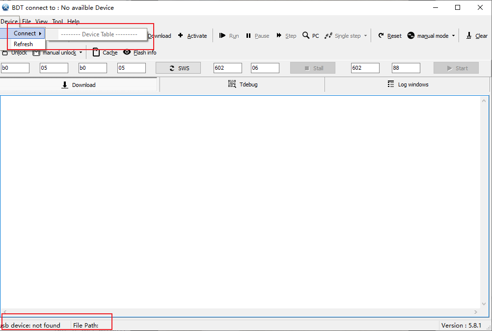

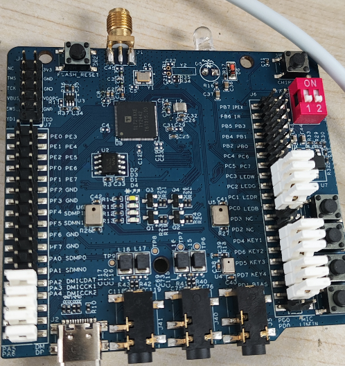

如题,开发板通过USB直接连接到电脑,电脑打开BDT(已安装驱动)搜寻不到设备。ADJ已通过跳线帽连接到VBAT,芯片有3V3供电。请问开发板支持USB下载吗?能否提供下这块开发板的资料?感激不尽

是的,根据一篇使用说明所述应该是需要烧录器。原文如下: 2.2 Download firmware
There are also two ways to download firmware, USB
burning or SWS burning. But need another burning tool
Telink Burning EVK . Telink Burning EVK have USB port
and 3.3V/SWS/GND port . When using USB download
firmware,just plugEVKUSBinBurningEVK.Whenusing
SWSdownload firmware, connect 3.3V/SWS/GND of EVK
to 3.3V/SWM/GNDofBurningEVK
35

TL721X目前不支持USB烧录
