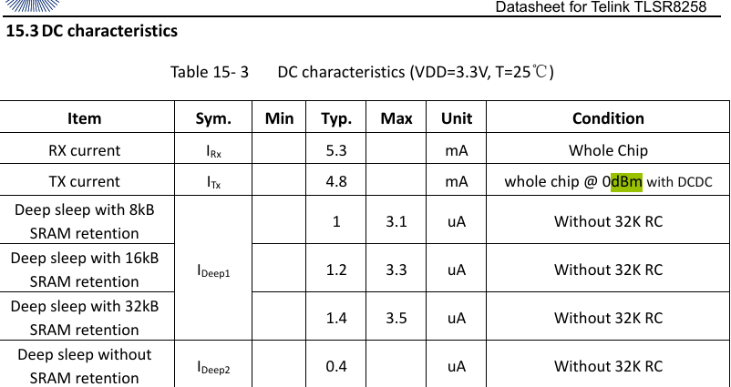

Why is the power consumption the same when setting the RF power to both 0 dBm and 3 dBm, and why does changing the RF power not cause any variation in power consumption?

Because of mesh nodes, Rf power is configured for packet transmission. Throughout the entire process, sending packets only takes up a small amount of time, while others are receiving packets, so the power consumption of 3 and 0 does not seem to differ much

But here for 0 dbm 4.8mA is there its consuming 7 mA

这个是mcu stall下的功耗,7ma是包含mcu运行功耗
