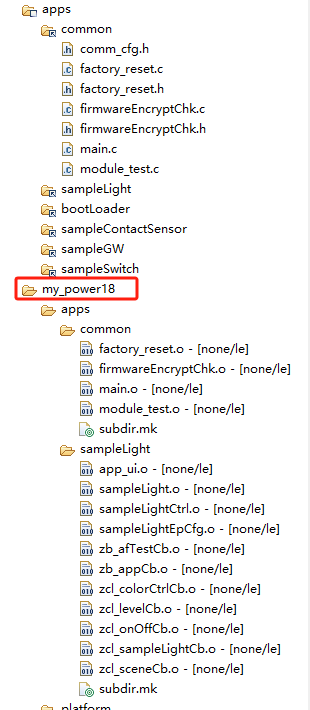

我创建自己的工程,可是main.c 里面的文件还是共用?
有没有介绍,自己的工程文件添加方式?

Read Telink ZigBee SDK Developer Manual - starting from 2.1.4
2.1.4 Add new project
In the provided SDK, only some simple use cases are listed. Users can add their own application projects
and compiling options according to their needs.
The detailed steps are as follows.
