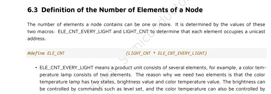

发表于 2024-12-30 14:57:34 | 显示全部楼层 来自 广东深圳
Can be modified. The model and element configuration information of a node are configured by the composition data (model_sig_cfg_s_cps), which is configured by enabling and disabling function switches, such as the color temperature function being LIGHT_TYPE_CT_EN, to ultimately complete the configuration of MD_ID_ARRAY_PRIMARY, that is, the composition data (model_sig_cfg_s_cps).
The number of elements is configured by configuring Light_CNT and ELE_CNT_EVERY_LIGHT。as detailed in Chapter 6.3 of the Handbook.
