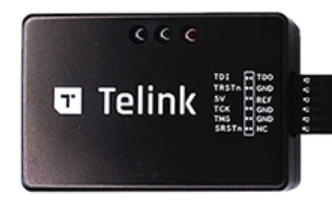

2、you need buy debugger.you can burning and debug the program through the SWS interface,the burning evk shown in the following figure
you can also burning and debug the program through the jtag interface,telink jtag debugger evk shown in the following figure
You can see the website:https://wiki.telink-semi.cn/wiki/ and https://doc.telink-semi.cn/doc/en/
