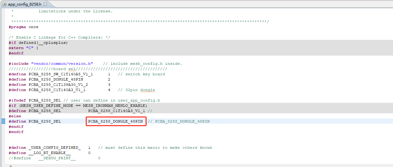

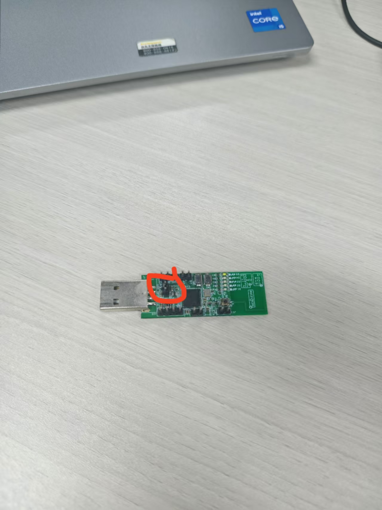

发表于 2024-12-6 11:18:15 | 显示全部楼层 来自 广东深圳
Burn the switch project on the dongle board of Telink according to the changes in the diagram to test the current. The default is deep rent, and the expected current is 2ua. First, rule out whether it is a hardware problem. During testing, it is necessary to remove the jumper cap from the dongle.
