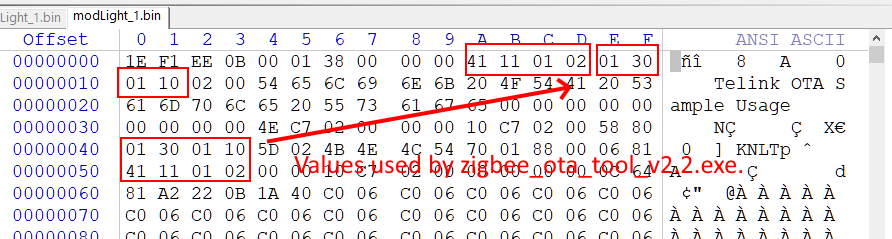

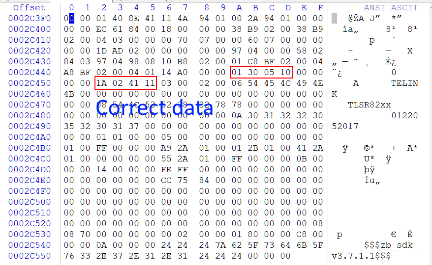

The firmware with the higher file version is compiled with the same SDK and transfered into the Gateway.
But as I mentioned before, zigbee_ota_tool_v2.2.exe doesn't update the header with the correct type or file version, so I had to update the header myself.
See the pictures showing it.

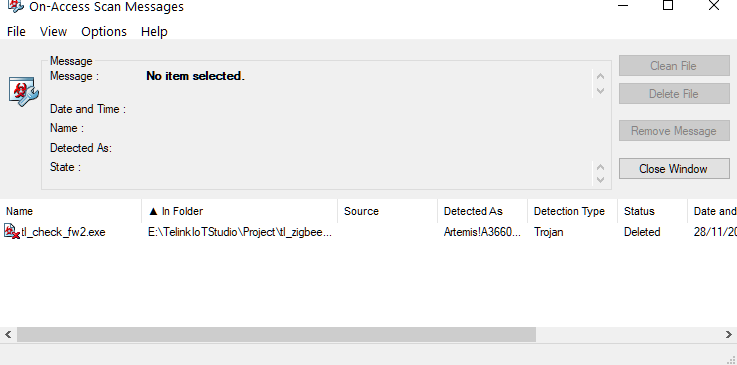

After spending a lot of time I have found the reson.
The file tl_check_fw2.exe has been deleted by virus scan.
In regards to the issue with the FILE_VERSION and IMAGE_TYPE I have found the following:
This is what I found in file cstartup_8258.S
.extern FILE_VERSION
    .extern MANUFACTURER_CODE_TELINK
    .extern IMAGE_TYPE
    .org 0x0
    tj    __reset
    .word    (FILE_VERSION)
    .org 0x8
    .word    (0x544c4e4b)
#if MOVE_BIN_CODE_EN
    .word    (0x00880000 + _bin_size_div_16)
#else
    .word    (0x00880000 + _ramcode_size_div_16_align_256_)
#endif
    .org 0x10
    tj        __irq
    .org 0x12
    .short  (MANUFACTURER_CODE_TELINK)
    .short  (IMAGE_TYPE)
in this startup assembly file FILE_VERSION and IMAGE_TYPE are not updated to the values defined in version_cfg.h. After renaming FILE_VERSION and IMAGE_TYPE to a different name in version_cfg.h the project still compiles. This means that cstartup_8258.S doesn't use those defines. So it can't work.

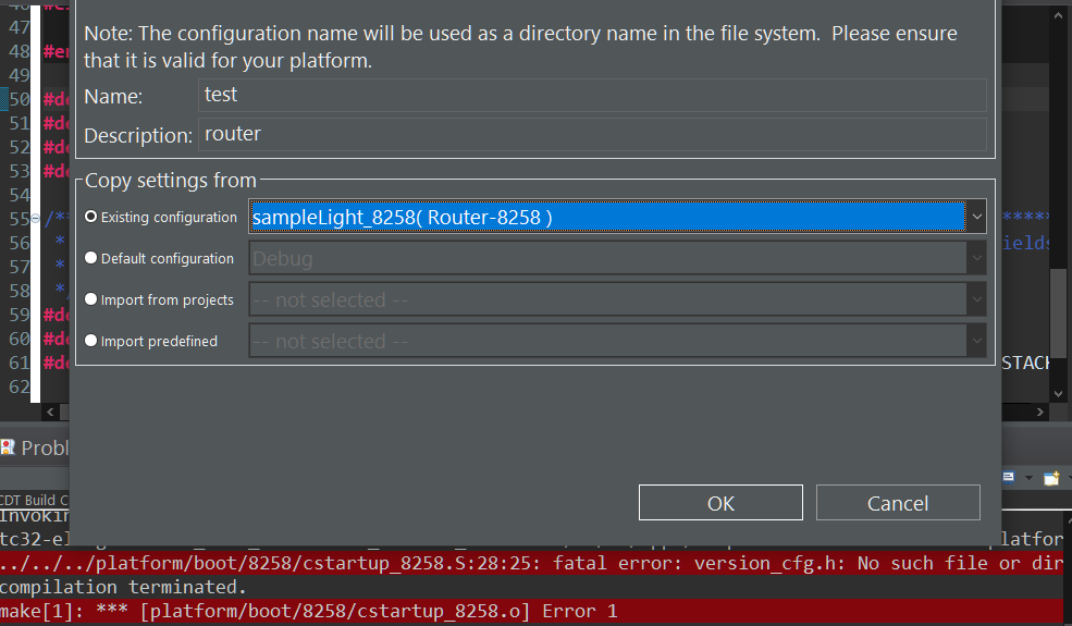

And I have tried another thing to check the issue with FILE_VERSION and IMAGE_TYPE.
When you create a new project configuration you use an option "Copy Settings from existing configuration" - see picture below.
My project was based on "Sample_Light" project configuration.

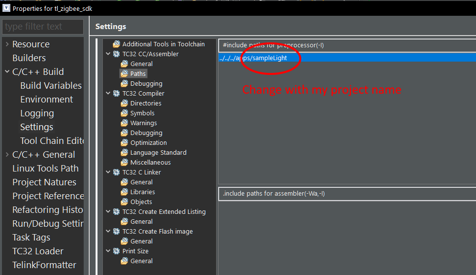

I deleted the "Sample_Light" folder from the app folder and the result was as on the picture below - error that version_cfg.h is missing. So startup_8258.S is using FILE_VERSION and IMAGE_TYPE from version_cfg.h in the Sample_Light project and not in my new project.
After searching in the project properties I found out where I have to make another change to replace SampleLight with my project/app name.
I wish that Telink described the process of creating new Configuration/Project in SDK manual. When you "Copy Settings" from configuration I would expect that everything is copied correctly and I don't have to make any changes. It doesn't tell you what other changes you have to make in project properties. This is the second change you have to make in the project properties.
