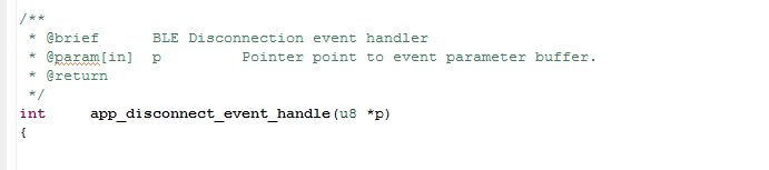

我现在用m1s1做从机给a设备(主机)连接,做主机去连接b设备(从机),但是这两个有一端断开连接了,我怎么判断是跟a设备断开连接还是跟b设备断开连接呢? image.png

可以在BLE ACL断开回调使用API dev_char_get_conn_role_by_connhandle(u16 connhandle) 查询当前连接的角色。
int         app_disconnect_event_handle(u8 *p)
    event_disconnection_t        *pCon = (event_disconnection_t *)p;
    u8 role = dev_char_get_conn_role_by_connhandle (pCon->connHandle);
    if(role == LL_ROLE_MASTER){
        //The local device is the central, the peer is the B device (peripheral)
    else if(role == LL_ROLE_SLAVE){
        //The local device is peripheral, the peer is device A (central)
    else{
        //no connection match
