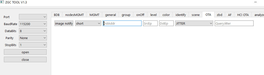

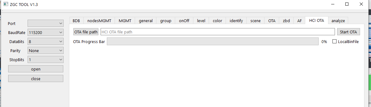

I use ZigBee BLE concurrent SDK on the Gateway. I can comumicate/connect to the gateway with my phone via BLE or via UART from the ESP32.
How can I upgrade any device firmware from the Gateway via OTA?
Is there eny example available?
I have noticed that ZGC_TOOL has the tab for OTA. And there is another tab called HCI_OTA - which has an option to load the image. When I connect to the gateway from ZGC_TOOL, can I upgrade any device via OTA? How to do it?
372
1188
1188
发表于 2024-10-31 18:44:26 | 显示全部楼层 来自 上海
Hi,
Please refer to sections 2.3 and 6.4. (https://wiki.telink-semi.cn/doc/ ... eloper%20Manual.pdf)
After importing the firmware of the device to be upgraded into GW, wait for the remote device to actively query and obtain it.
Of course, you can also directly click on "image notify" to notify the remote device to query immediately.

 楼主| 发表于 2024-11-1 13:27:57 | 显示全部楼层 来自 澳大利亚
TL_YB 发表于 2024-10-31 18:44
Hi,
Please refer to sections 2.3 and 6.4. (https://wiki.telink-semi.cn/doc/an/AN-19052900-E_Telink%2 ...
Hi,
I have read section 6.4 of the manual, but I have still one more question before I start testing it:
#1. I download the required OTA file using ZGC_TOOL and HCI_OTA tab into the OTA-Image area in the Flash of the OTA server (gateway)..
#2. I select device address and EP and click "Image Notify" in OTA tab in ZGZ_TOOL
- Do I have to do anything in the Gateway? Or does the Gateway transfer the firmware when it is ready?
- If I don't do step #2 what do I have to do in the gateway to start transfer? You wrote "wait for the remote device to actively query and obtain it". So what does it mean "and obtain it" - is there something I have to do?
That's what is not clear to my about this process of the firmware transfer from Gateway to the device
There is the following in the manual for the server:
After the OTA server invokes the ota_init function, it will automatically load the information of the OTA image.
And for the Client/device the following:
After invoking the ota_init function, the OTA Client will automatically reload the last OTA progress information.
If joining in a network successfully, it will start the OTA request after the set seconds.
And that is all information in the manual.
What are the messages in section 8.7 8.7 HCI serial port upgrade command for?
Are they the messages send from ZGC_TOOL to the gateway?

 楼主| 发表于 2024-11-2 09:50:53 | 显示全部楼层 来自 澳大利亚
I have decided to do some tests. I made a new gateway and one router device.
I used ZGC_TOOL HCI_OTA tab. I have tried a couple of times but it gets to 15%, 22% etc. and it fails.

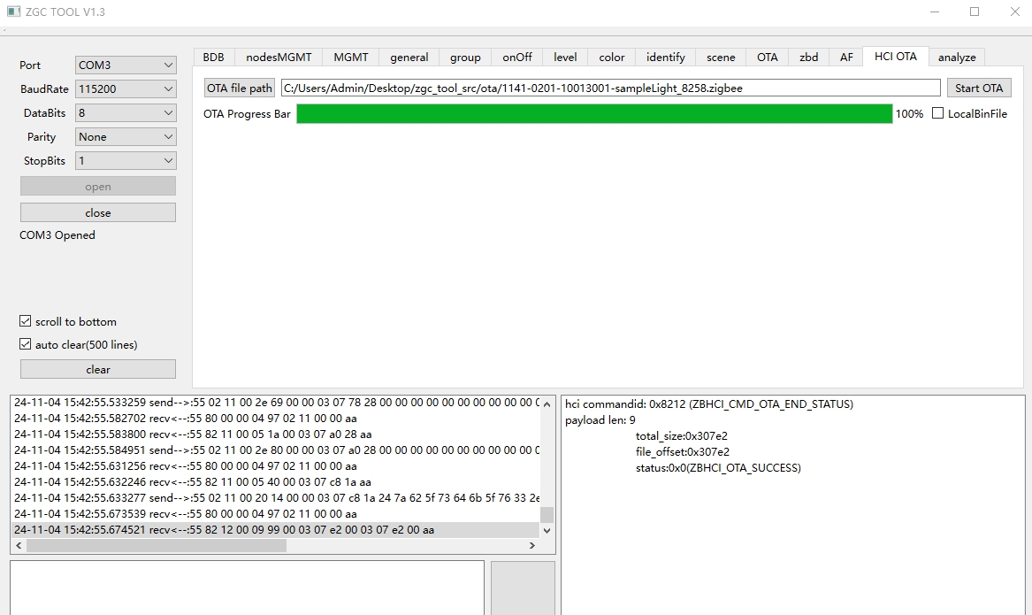

发表于 2024-11-4 14:38:58 | 显示全部楼层 来自 上海
What is your SDK version and ZGC version?
113
587
587
 楼主| 发表于 2024-11-4 14:54:26 | 显示全部楼层 来自 澳大利亚
ZGC version is 1.3 and SDK is version 3.7.1.0. I was using the Sample gateway example from this SDK without any modification. The chip is TLSR8258.
I have also tried one of the previous versions on the SDK. And the same thing happened
I have attached the whole capture file so you can see that towards the end of the capture "BAD MESSAGE" occured coupled of times then it contiunued with the next block and then it happened again and finally it stopped.
If you have any suggestion what I could add to the code to see what happens when this occurs please let me know. You could probably do the test yourself and see if it works for you.

发表于 2024-11-4 15:57:18 | 显示全部楼层 来自 上海
Hi,
I tried the HCI OTA function with sampleGW(ZBHCI_UART set to 1) and sampleLight in V3.7.1.0, and there were no abnormalities during uploading.
From the log you provided, it appears that the response data received by GW requesting UART data was abnormal, causing the request to time out.
