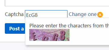

This entering Captcha is annoying. especially if it doesn't work. How many time can you try.
I tried EcC8, EcG8, Ec68 and nothing works. Why do you have it here?
See attached picture.
