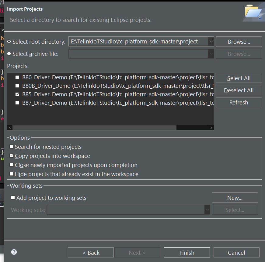

I try to import TLSR8258 driver projects (which are now on github) into IoT Studio using import from existing project - that's how I always did in the past.
See picture 1 below

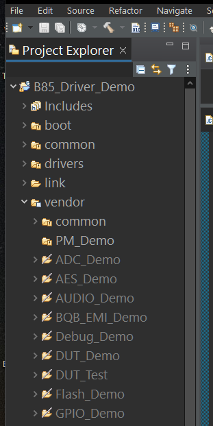

When the import finishes I can't see any files in the vendor/eample folders. The example source files are not imported - see picture 2 (for example PM_Demo folder is empty, no source files)
I tried many times but can't get it to work. I never had this issue in the past. What is the correct way to do it?
Picture 1
Picture 1
Picture 2
Picture 2

 楼主| 发表于 2024-10-3 06:39:08 | 显示全部楼层 来自 澳大利亚
I got this to work when I deselect "Copy projects into workspace" when importing the project - see picture 1 in previous post.
I thought it makes sense that you want to copy projects into workspace, but it seems that it doesn't.
