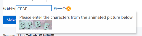

I enter the correct code but it tells me it is incorrect. I have tried multiple of times. I can't make a post
Could you fix this. It is annoying.
