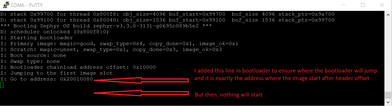

Bootloader starts normally and can see the image, confirm it s validity, and jump to the correct address on the flash. But.. the code does not start....
I repeated the work for (Blinky project and hellow_world project) but got the same result.
All these codes work normally without bootloader but with bootloader nothing works.

Your address seems wrong, as the tlsr9518adk80d.dts file shows, the slot0 is 0x18000, not 0x10080.
On my side everything works fine, here's my steps(use hello_word as example):
1. build mcuboot
west build -b tlsr9518adk80d -d build_mcuboot bootloader/mcuboot/boot/zephyr
2. build hello_word sample
west build -b tlsr9518adk80d -s zephyr/samples/hello_world -d build-hello-signed -- \ -DCONFIG_BOOTLOADER_MCUBOOT=y \ -DCONFIG_MCUBOOT_SIGNATURE_KEY_FILE=\"bootloader/mcuboot/root-rsa-2048.pem\"
3. sign the hello_word sample
west sign -t imgtool -p bootloader/mcuboot/scripts/imgtool.py -d build-hello-signed -- --key bootloader/mcuboot/root-rsa-2048.pem
4. flash mcuboot to address 0x0, flash signed hello word sample(zephyr.signed.bin, not zephyr.bin) to address 0x18000, then it works.

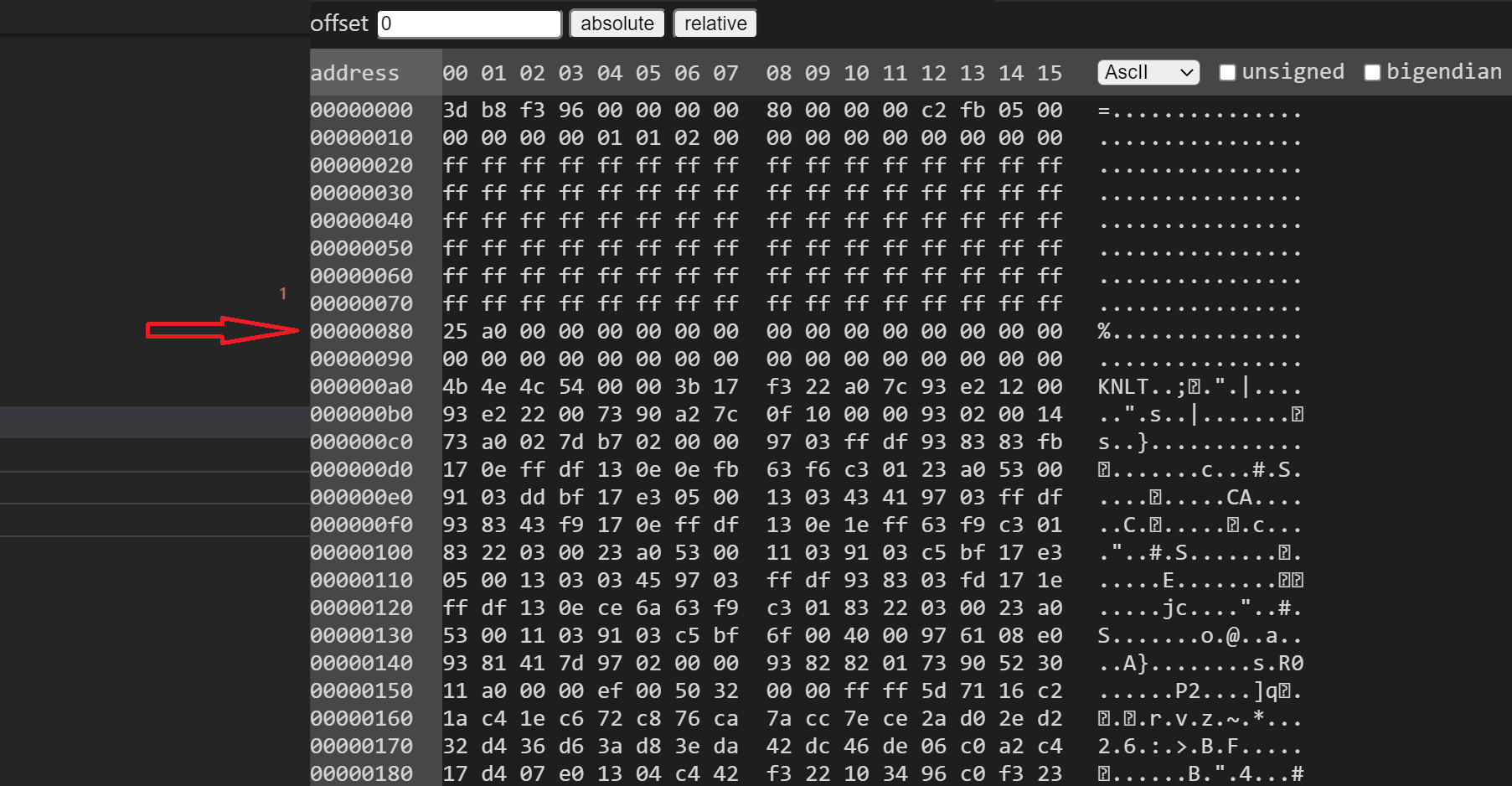

I noticed that, on my version of zephyr the slot-0 start from 0x10000, and the offset 0x80 is because I uses the sign key with pad-header 128 bytes. Signing the .bin code without adding the header will return me an error.
west sign -d build_hellow_world -t imgtool -- --pad --version 1.1.2 --pad-header --header-size 128 --key root-rsa-2048.pem
Now i am sure that the problem in the version of zephyr_SDK. Could you tell me please which version of zephyr you are using?

I‘m using the Zephyr from telink-semi repo, here is the specific Zephyr commit id: 873afebff10dc02ec881e2432a885e54c9f67b10

Yes, the problem was resolved by replacing the Zephyr.
