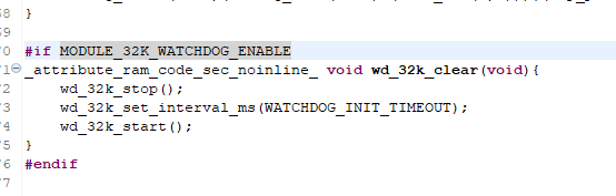

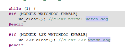

In the provided SDK, there is already have the present of the watchdog feature, but currently during the ESD test, up to a level the device couldnt meet the requiremnts to automatically reset after a crash. i aint really good at this as i am still learning, is there any way or guidelines be provided to overcome this issue. thank you.

Set a suitable feeding interval for the watchdog, as the watchdog will be turned off during feeding, and if the fault occurs at this moment, it cannot be restored.
