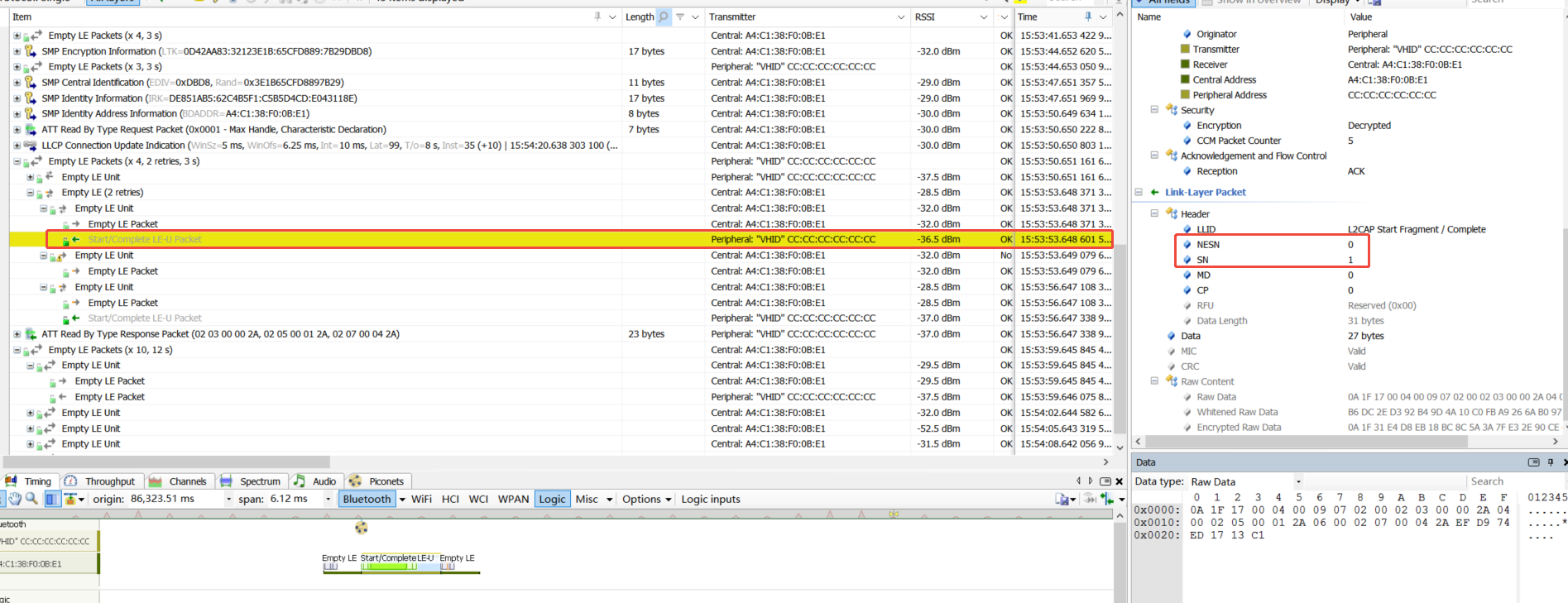

It looks like you have SMP enabled in your case? In my case SMP is disabled (BLE_APP_SECURITY_ENABLE 0), maybe that is what causes this? You have caused a drop of an "empty packet" in your capture I think? In my case there is a loss of the "read response" which is then not retransmitted. It would be great if you could simulate a loss of that read response packet and see if that one is also retransmitted in your tests. If there is a bug that removes the read response packet from the TX FIFO after sending and before confirmation this bug can not be seen for empty packets as they are not part of the FIFO.

It's not an empty packet that's lost — as you can see from the diagram, the lost packet is an ATT response packet.

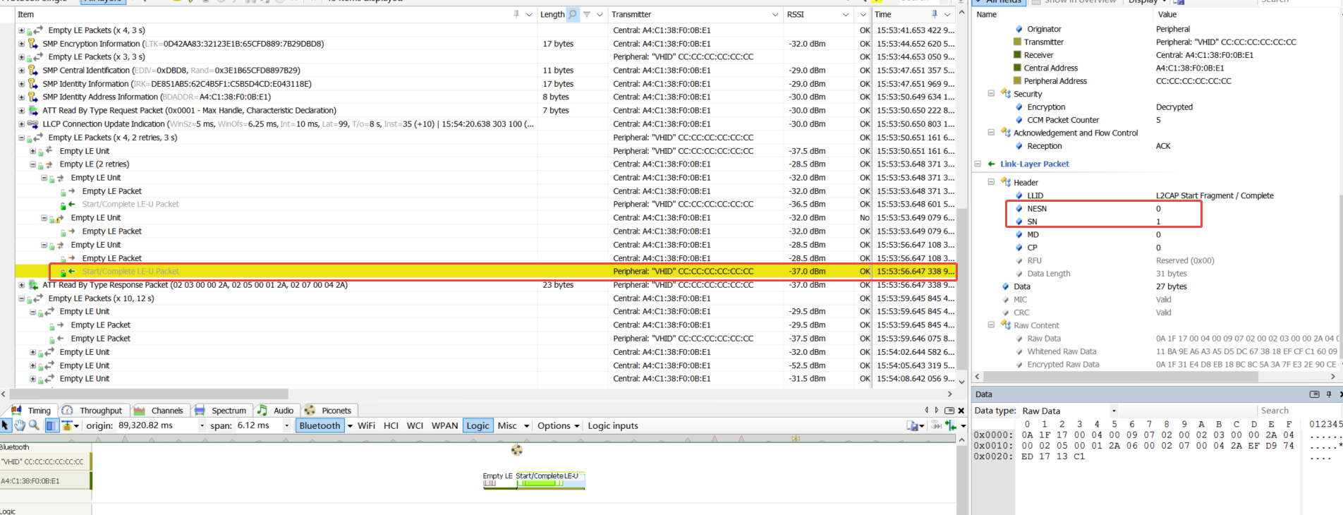

Then I don't understand your capture screenshots yet. I only see a single ATT response packet and the red marked packets which are retransmitted are empty packets? If you simulated a loss of that ATT response packet on the central using the method I described then it should show up on the sniffer (as it was actually transmitted) but not on the central (as it was "lost", or dropped in this case with the test setup). So the centrals next expected sequence numbers should indicate, that the packet needs to be retransmitted. Then the peripheral should retransmit the ATT response packet (using the same sequence number as before), and it should show up again on the sniffer (which I can not see on your screenshot, there is only a single ATT response packet). This time the central should receive it and it should be fine then.

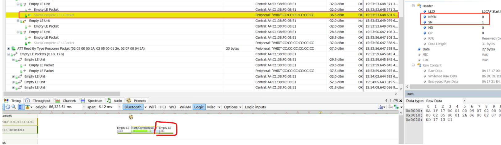

This diagram matches what you described: the loss of the ATT response packet was simulated on the central, and this packet does show up in the sniffer.
In the next interval, the central retransmits an empty packet with the same SN (Sequence Number) and NESN (Next Expected Sequence Number) — this indicates that the aforementioned packet needs to be retransmitted.
After that, the peripheral retransmits the ATT response packet (using the same sequence number as before), and this retransmitted packet does appear again in the sniffer. We have already verified this.
In an Ellisys packet capture, if the color in the middle of an empty packet is red (rather than gray), it indicates the packet is not received. This is parsed based on the SN (Sequence Number) and NESN (Next Expected Sequence Number).
