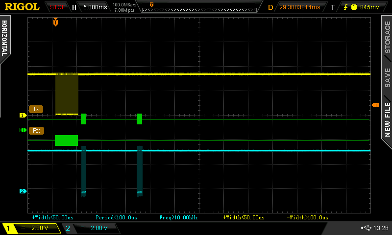

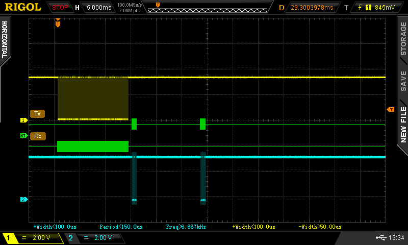

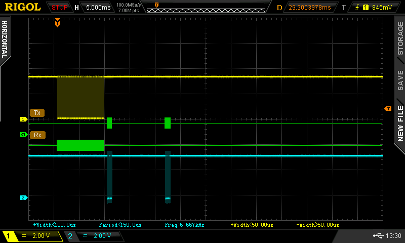

And the last test was using the scope to have a look at the packets captured.
Normal 1 packet and responses - see picture 1-pkt.png and 1-pkt.csv
2 packets sent without response after the first one - see picture 2-pkt.png and 2-pkt.csv
3 packets sent without responses between the packets - see picture 3-pkt.png and 3-pkt.csv
What do you think?

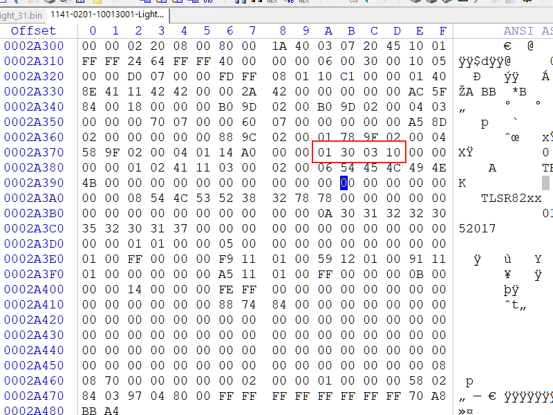

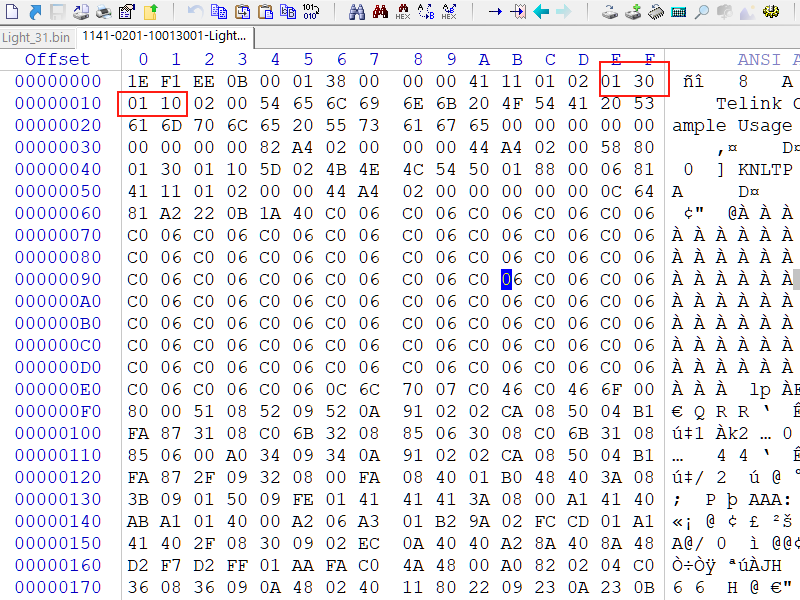

But file version are not the same. Here are the pictures of the files.
image1.png shows the header added to the .bin file by zigbee_ota_tool_v2.2.exe
image2.png show the end of this file which shows the file version.
You can see that file version is 03 not 01. Why?

1 I have manually changed the file version number in the header of the file - at offset 10.
I have tried and changed in the project all: APP_RELEASE, APP_BUILD, STACK_RELEASE and STACK_BUILD but none of the values has changed in the added header. So this doesn't work at all!
- So, this has to be fixed

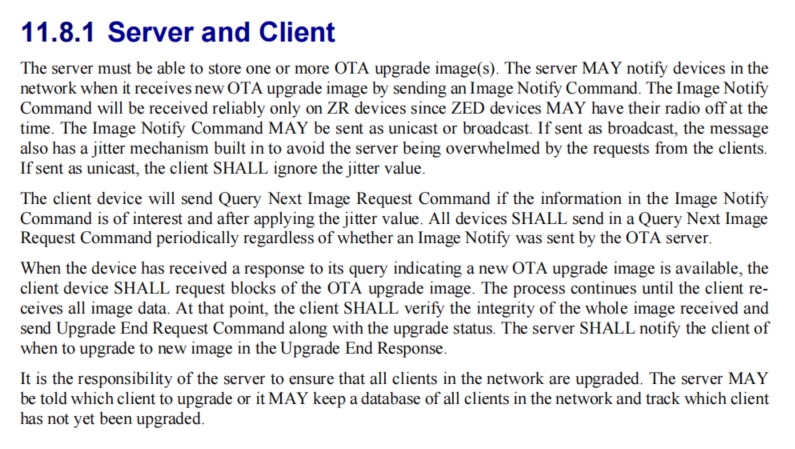

发表于 2024-11-25 16:27:21 | 显示全部楼层 来自 上海
Hi~
OTA protocol can refer to "Zigbee Cluster Library Specification R7".
https://csa-iot.org/developer-re ... s-download-request/

Thanks for the information.
It looks like "Image Notify" from Server to the Client is optional.
Since I only program device for myself, I will do it the way I want.
I made some changes to the ota.c file and it works the way I want.

From the Cluster library Specification:
11.13.3.2.5 (new) Fi le Version
The value SHALL be the OTA upgrade file version that the server tries to upgrade client devices in the network to. If the server intends for the command to be applied to all file version values then the wild card value (0xffffffff) SHOULD be used. See section 11.10.3 for detailed description.
This means that when I had specified higher file version then it shouldn't update devices with different file versions. So this didn't work for me. All devices were updated.
Only if you us wild card 0xFFFFFFFF, this should happen.
11.10.12 UpgradeActivationPolicy Attribute
This attribute indicates what behavior the client device supports for activating a fully downloaded but not installed upgrade image. Table 11-12 below lists the enumerated values and the descriptions
There is no such attribute in the Telink SDK!
