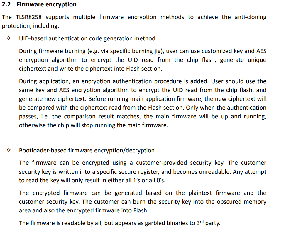

The TLSR8258F512 supports multiple firmware encryption methods to achieve the anti-cloning protection, including:
This gives us a good overview, but unfortunately there are no examples, workflows, or SDK references that show how to actually implement these features.

Have a look here and response from Telink : https://forum.telink-semi.cn/forum.php?mod=viewthread&tid=580&extra=page%3D6
8258 does not support firmware encryption
